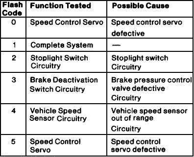

Вот нарыл в нете инфу. Перепечатка предположительно из Alldata.com
Речь идёт о тестировании блока Круиз-контроля на Виндстаре 3.0 1998 г.
To Enter Self-Test:
1. Fully engage parking brake. Make sure brake pedal is released.
2. Begin static portion of self-test by pressing and holding speed control OFF switch.
3. Turn ignition switch from OFF to RUN. The CRUISE indicator on the instrument cluster will flash once to indicate the speed control module has entered diagnostic mode. If the CRUISE indicator does not flash repeat Steps 1-3. If the CRUISE indicator still does not flash, diagnose the CRUISE indicator.
4. Release the OFF switch.
5. The CRUISE indicator will flash as each switch is pressed while performing self-test. Press each switch in the order described while observing CRUISE indicator for a flash. Note any switch activation that does not cause a flash. Within 5 seconds of turning the ignition switch to RUN:
• Press the ON switch.
• Press the RESUME switch.
• Press the COAST switch.
• Press the SET/ACCEL switch.
6. NOTE: The ON switch must be pressed within 5 seconds after entering diagnostic mode or the speed control module will return to normal operating state and self-test must be repeated
А что делать тем, у кого нету индикатора круиза?
